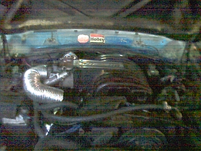

Howdy Guys/Gals . I just finnished fuel injecting the 302 in my 70 Grabber (I put the 302 in 8 years ago) . I used mainly 89-92 Mustang parts for the fuel injection . I had no problems fitting the higher intake manifold under the Grabber hood (I added that too) . I would recomend this retrofit to all of you that currently have 302's, it's not as difficult as it first appears. I have also included a picture of the engine . Forgive the dirt, I have since cleaned it, and some modifications will need to be done to the shock/spring tower to firewall braces . Doug | Uploaded file |
