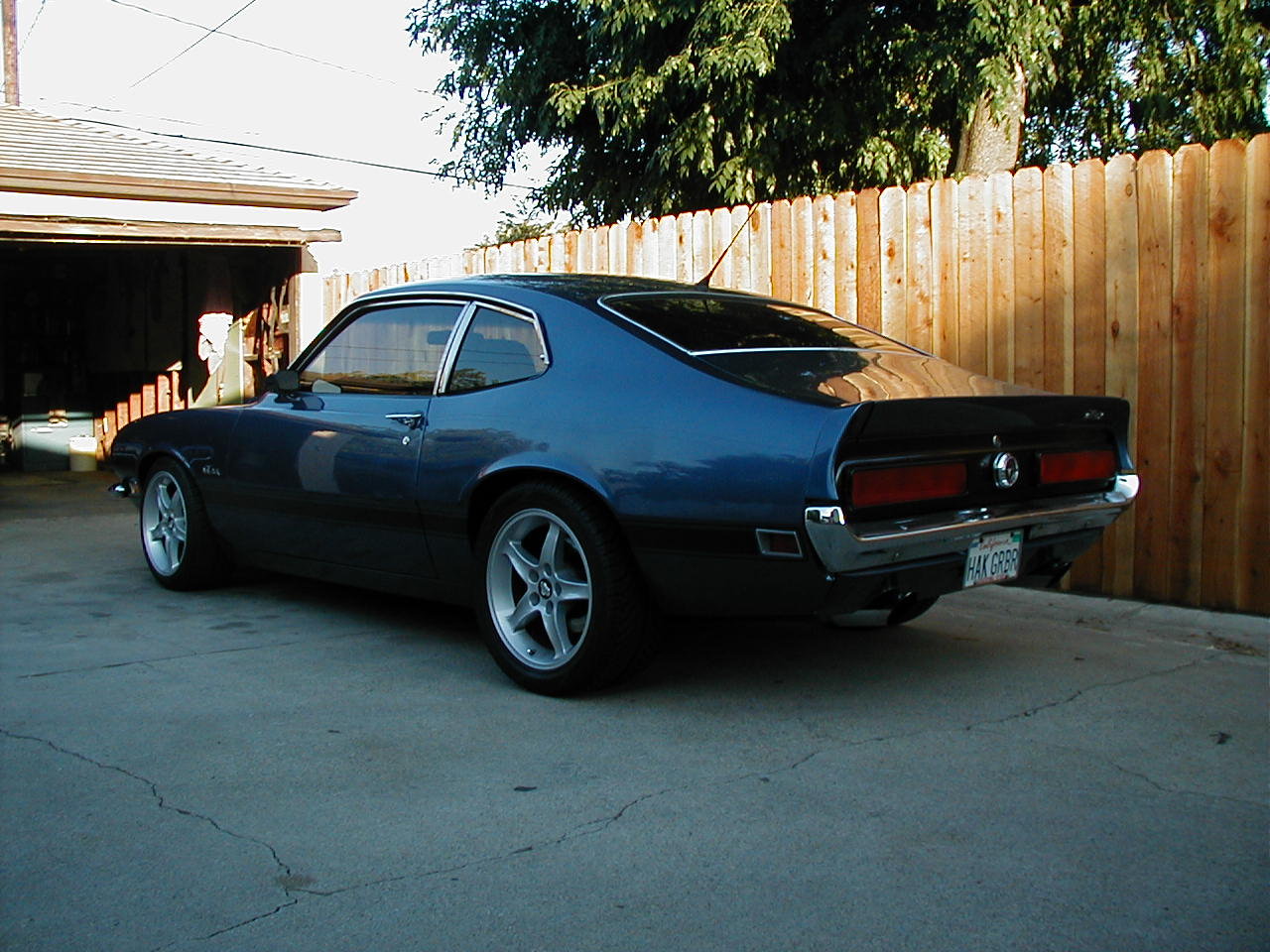

I just got one of the $5000 check last friday so I can start soon. We bought a 73 six cyl 2 door for the body I plan to add the tubular mustang II front end from Rod & customs. Power windows, remote door locks, cruise control for the 2000 mile trek to Indiana. I found these cool remote rear vent window openers from a dodge caravan I'm going to try and put them on the Mav (I hate the fact you have to stop to open them now) I going to do a better blending job on the Thunder bird tail lights.
I'm also going to build a new motor I have a 90 roller block here's the list for it Edelbrock RPM heads, air gap mani, 600 holley, e303 cam, TRW forged piston 10/1, crane 1.6 roller rockers, should have some power to have fun with.
The rims that I have are 17x9 and the tires are 245/40-17 front and 275/40-17 rear I have a 1.375" front spacer with offset five studs and a 61" wide rear axle to compesate for the offset of the cobra Rs
I'm going to the show in july hope to see you there.
Tom H
