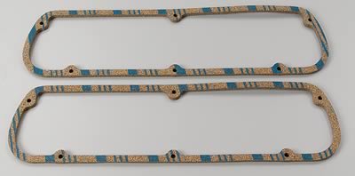

    Yeah, these are great. Thats all you would need. Fel-Pro 1645s at Summit.
    FPP-1645
    $32.95
    Estimated Ship Date: Tomorrow
    [​IMG][​IMG][​IMG][​IMG][​IMG][​IMG][​IMG][​IMG][​IMG][​IMG]Brand:Fel-Pro PerformanceProduct Line:Fel-Pro Performance CorkLam Valve Cover GasketsPart Type:Valve Cover GasketsGasket Material:Cork/Rubber with steel coreThickness (in):0.313 in.Quantity:Sold as a pair.Notes:Cork-Lam construction utilizes a metal core with a cork-rubber material chemically bonded to both sides.Valve Cover Gaskets, CorkLame, Cork/Rubber with Steel Core, Ford/Lincoln/Mercury, Small Block/351W, Pair
    Counter blowout or high-vacuum conditions.
    Certain engines, such as small block and big block Chevys, can produce high-vacuum or blowout conditions that can be big problems for many valve cover gaskets. Fel-Pro Performance CorkLam gaskets are designed to deal with those challenges. They have a metal core for extra strength, with a special cork-and-rubber compound bonded to both sides. This produces tough gaskets that can deal with problem engines, while also providing a little extra clearance between the valve cover and the valvetrain.

    I've always wondered if the F/R stamped chrome ones clear, Ford says they don't. The Felpro laminated gaskets can be bought locally at your parts house. Advance Auto listed them.

    I am using the felpro rubber-embossed valve cover gaskets. Last set I will ever buy. So I don't have the ability to double them up. I am pretty sure the grooves and ridges would not line up and I would have a leak.
