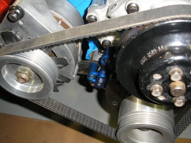

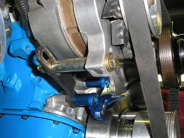

  4. Bryant
    summitracing sells these. they are copys of march brackets. on the bottom is rod link with to hiem joints for adjustment.

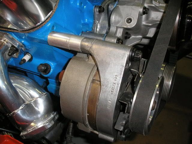

  5. bmcdaniel
    Jul 2, 2002
    6,841
    689
    318
    York. PA
    '70 Maverick Grabber
    Had to make some spacers out of pipe to get everything aligned. Stock brackets, modified the alt bracket to clear the 3G.

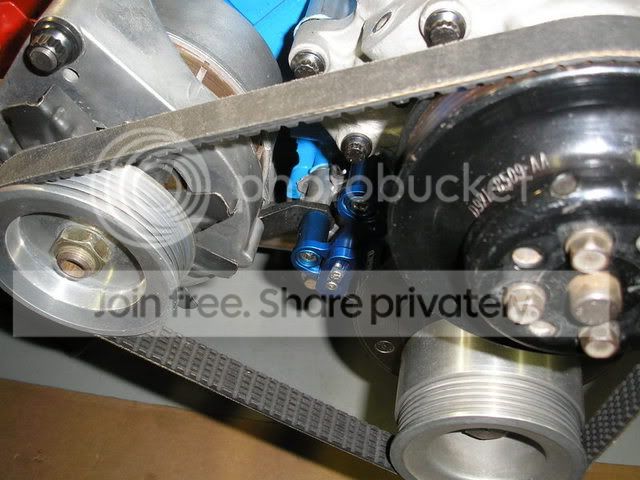

    9,018
    I just saw this on a another forum, Hope it helps (y)
