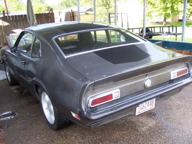

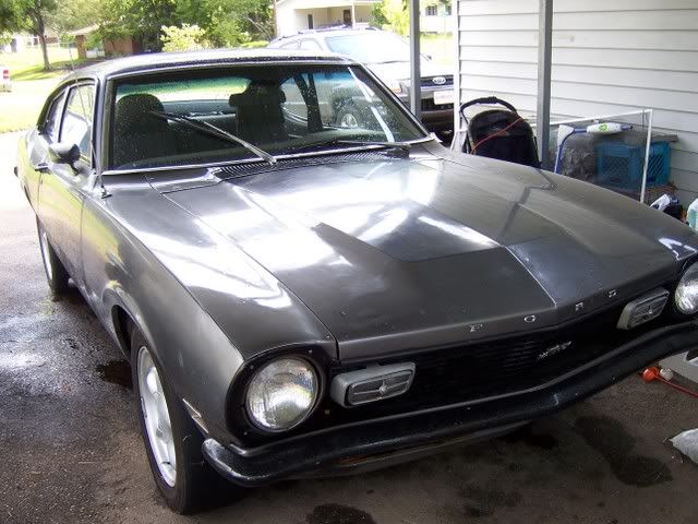

    you never know what people are thinking when there swaping eengines around. im sure you mean a straight 6, slant 6's were a chrystler product.
    do you have an pics?

    yeh i have a few pics....

    definatly not a bad looking car though. looks like it probably was a '73 that got back dated the the bumper swap on the front and graber spoiler rear. i dont think a 71-72 had the FORD across the hood or the turn signals in the grill. check again for the sticker in the dr side door jam. they look like there a PITA to get off. more than likley it got painted over.
    good luck

    I think what you have there is two things:
    1. A car built with a collage of parts off of different year Mavericks.
    2. Probably a VIN swap from a another car.

    If the vin is correct, the grabber rear spoiler is suppose to be there.
