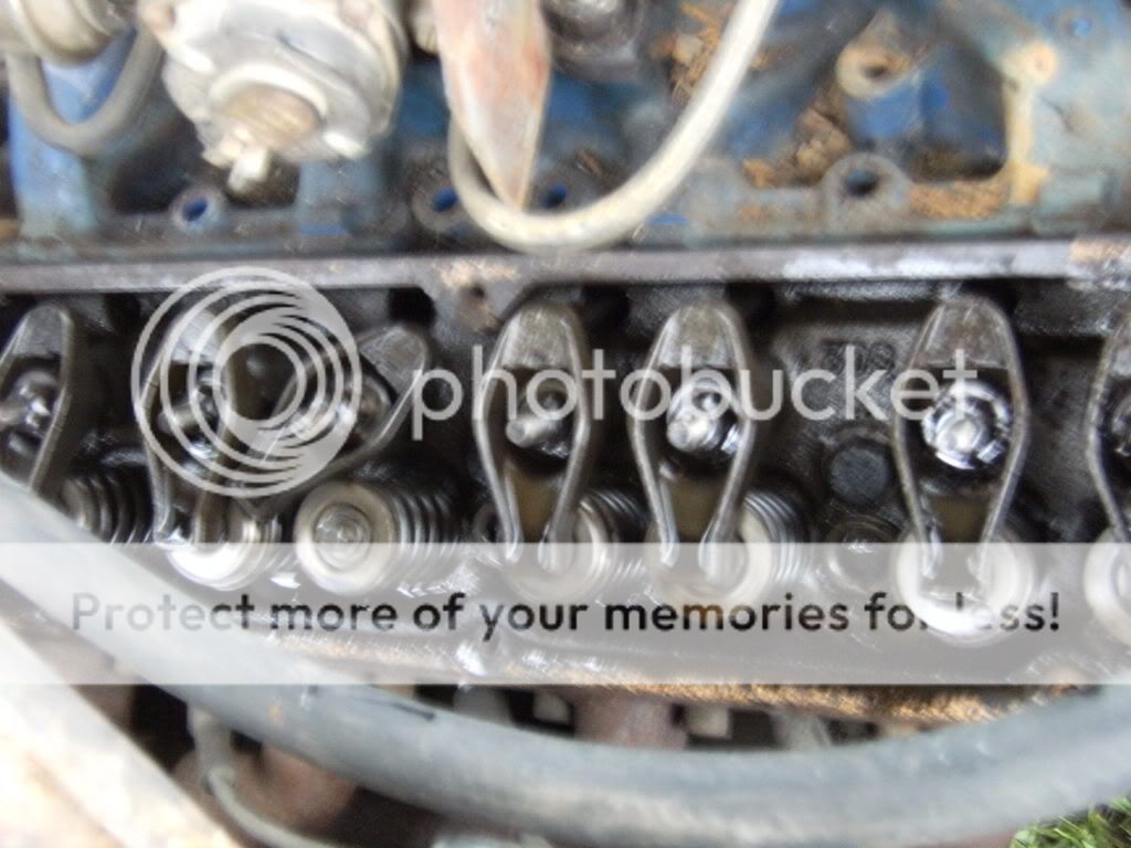

    No engine pulling yet,perhaps a head though.Get a good pic if the valvetrain that showes all 8 valvesprings/rockers as well as those bent pushrods.

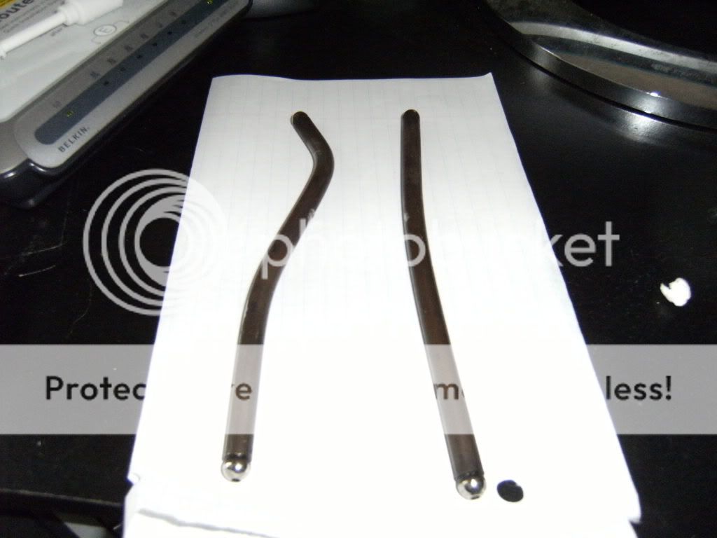

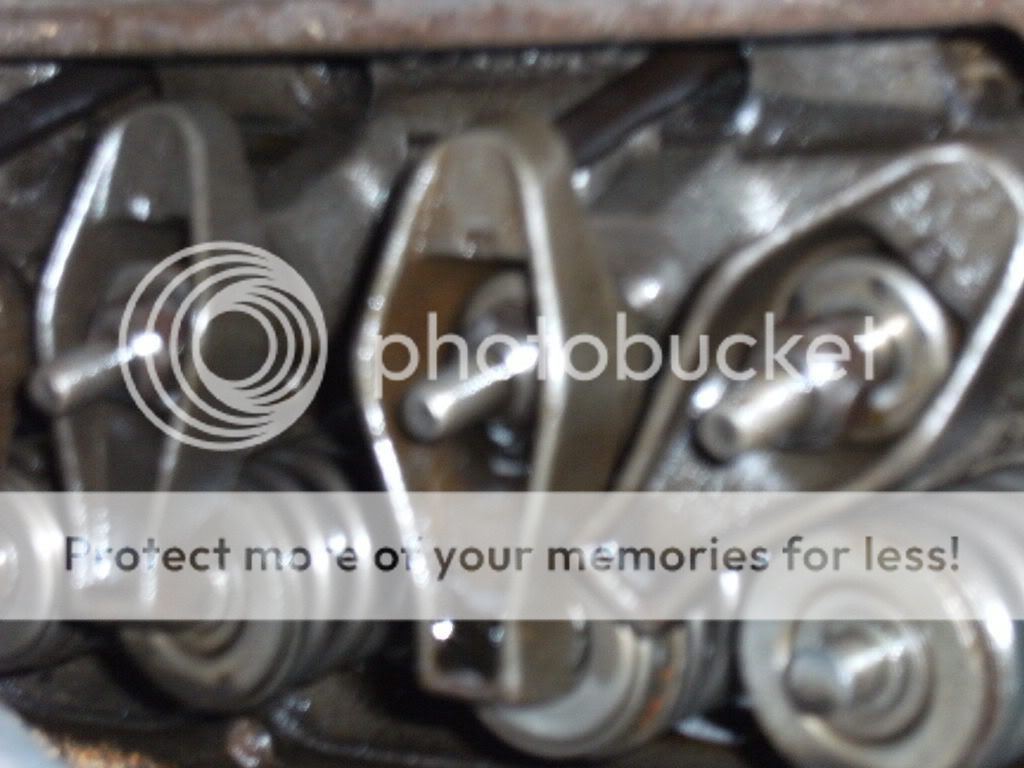

    Sorry for the delay but today was the first time it quit raining long enough for me to get to my valve covers off. I am not sure of the lenght due to it being bent but it was around 6 3/4 give or take if that helps?
    One of the rods wasnt coming out so I may have to pull my head after all. The debris may be from the gasket while removing the cover but cant be 100%. I had a friend tell me the burr on the rods meant they were cheap and that is what grabbed and bent them, and that i should be ok to just replace the rods. Not sure how true that is. Any suggestions on that idea or should i go ahead with pulling the heads to look for piston damage. I wouldnt see any hesitation in turning the motor to check for it hanging cause it cranks and idles fine...right???

    I couldnt help but notice that there seem to be no intake manifold bolts on the right side.Did you remove them or were they just not there???If they just werent there...that would explain the poor running (Vacuum leak)Big one...between the head and intake.(This has nothing to do with the bent pushrods)Those burrs your freind was talking about wouldnt happen to be the gouges in the side of the bent push rod in the pic by any chance???those marks were caused by that pushrod getting bent against the head each time the cam cycled that particular push rod.
