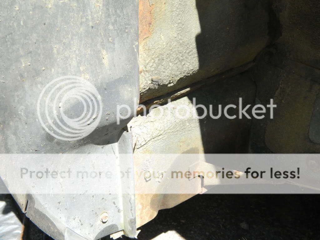

  9. 71gold
    just from looking in the drain hole it looks like there will be some fab work to be done.
    do you have any pics of under the bottom side?

    The only under pics I have are of the torque boxes. Here they are:
