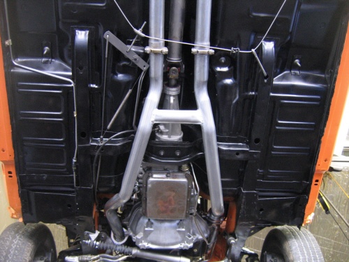

    Thanks for the nice words. Craig used the reducers supplied but had his exhaust guy, beautiful work BTW :) , cut them down to make the turn towards the ground. You will need at least the flared portion of the reducer to seal against the dome on the header. Your exhaust man should know exactly what to do when you hand him the reducers.

    Yes....I used the reducers. To get it on the trailer.....I just tack welded an elbow piece to the reducers (to be removed later). I couldn't turn left and the passenger side was hitting the firewall....but it worked until I got it to the shop.
