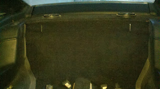

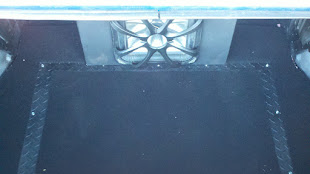

    I did both
    Maybe Ill add some more screws to the tank cover. It looks slim looking at these photos.

    GrabberGT: where did you put your firewall? on the passenger side or the trunk side of the metal braces? how did you close up to the speakers?
    i want to use the speakers, so maybe best is to put another sheetmetal underneath, sealing the trunk.

    Did you have any trouble fitting the back seat? And what gage of metal did you use?
  13. mav1970
    Chris, would you mind sending these 2 photos to me at mav1970@yahoo.com ? I want to blow them up so I can look at them better but I can't do that the way you attached them to your original post - Thanks :Handshake
