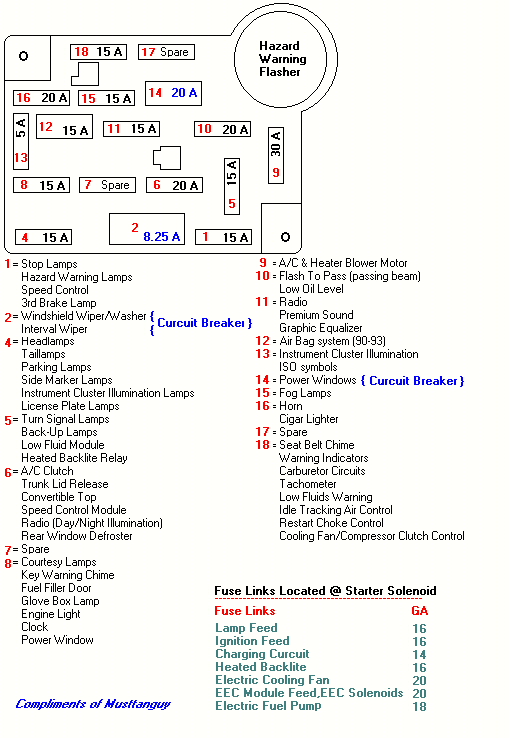

    was given a fuse panel out of a 90's ford aerostar..thinking about changing it out what do you guys think?? pic of the fuse pannel layout is at www.ponyperformance.com/foxfusebx
