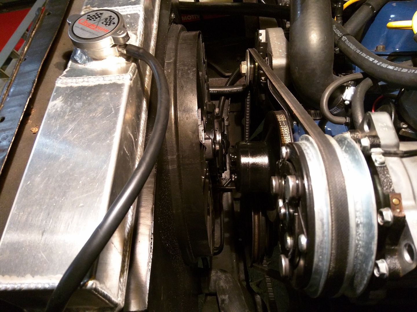

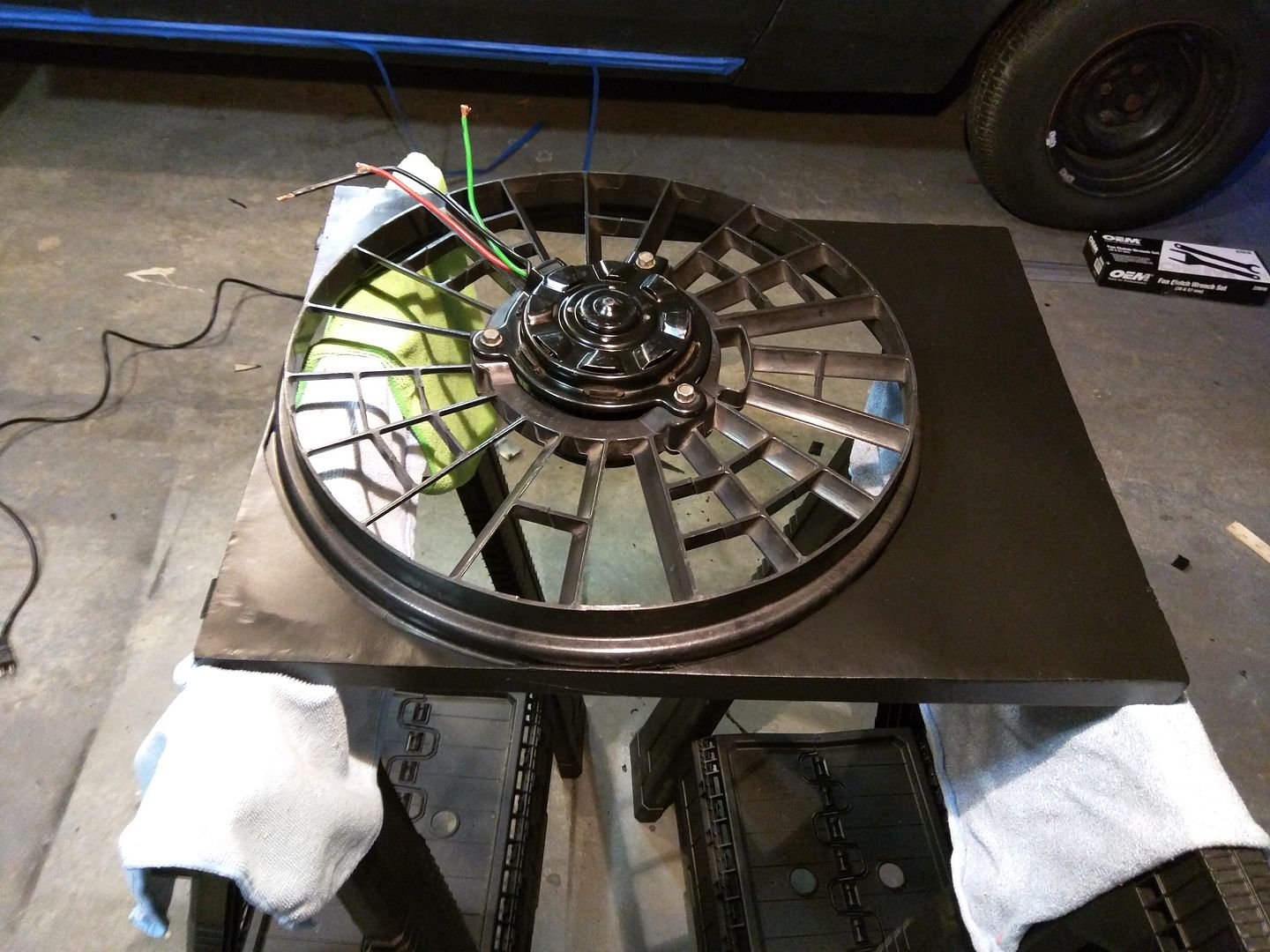

  7. 71gold
    "Volvo electric fan with custom shroud".
    why did you need a custom shroud with the fan? got a pic. of this setup?
  8. mrmalina99
    mrmalina99 Member
    Oct 20, 2010
    753
    86
    Belfair, WA
    1973 Maverick
    Fan would not clear water pump pulley with Volvo shroud, so I had to make one low profile and off center.

    If the efan is running while you're driving into 70 mph wind ramming its way into the engine bay?.. you have something very off. Heavily retarded timing can also cause this issue too. Have you ever dialed in this tune with a timing light and vacuum gauge?
    Also be sure to have the vacuum advance canister on the distributor connected to FULL manifold vacuum.. NOT ported source on the carb. Won't make much difference at the highway cruising speeds you're talking about here.. but it will most definitely help add more timing lead during idle and very light throttle angles where the ported source hasn't kicked in yet.
    PS.. doubtful that it's all the issue you're seeing here.. but that shroud is pretty shallow(creating dead/reduced flow regions) and could create a damming affect which reduces total cfm past the full core area of the rad at higher speeds. Remember that air doesn't really like to turn that quickly and prefers smoother transitions when at all possible. That could stifle flow enough through that too small hole to require the efans assistance to pass enough air past the core. An easy test would be to temporarily delete it to see if the added airflow past the core at highway speeds cures some of the issue.
  10. 71gold
    that looks like the same shroud that came with my fan.

    Its very close but I had to make one because I needed my fan off center and not in middle.
