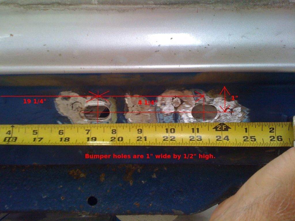

    I've searched around and there is plenty of info on what to do, but I need measurements on where to drill the holes for my rear brackets. There is plenty of info and templates for the front, but I haven't seen anything for the rear. I don't have access to a small bumper car to take measurements from, so I need your help. Thanks, Brad

    Thank you very much!! I'm assuming the 19 1/4 is from the center of the other inside hole? Is there a measurement from the outside of the car to one of those holes? This is a big help.
    Edit: I just ran out in the garage and I'm guessing it's 19 1/4 from the center of the car.

    When I did mine...I found the centerline of the car and went from there...but I had a bumper with a centerline marked on it that helped a lot. The bracket will sit on top of the frame rails. Drill holes in tail panel from the inside of trunk after welding the brackets to the trunk floor
