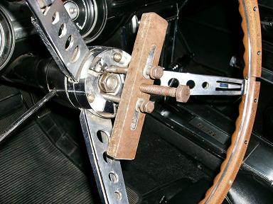

    I made my own puller years ago. The ex kelp it along with the house. I took a 1/2"x 1-1/4 flat stock and drilled holes and tap the center hole. It looked like this except it didn't have slotted holes.
