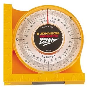

    I don't have special tools. I have a pinion angle degreeing doohicky, which should get me within a degree or two of where I need to be.
    Like this one...
