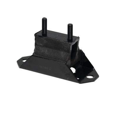

    here is the one that I'm using...the c4 mount...it actually looks a little shorter than the aod one, so perhaps this is the right one to use?
    [​IMG][​IMG]

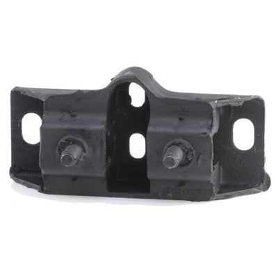

    now here is the aod mount...it almost looks taller...

    ok...it is the c4 mount that I'm supposed to use...I found an old aod mount vs the c4 mount...

    That AOD mount you have pictured, is way too tall. I just used a new poly C4 mount, and it slipped right in.

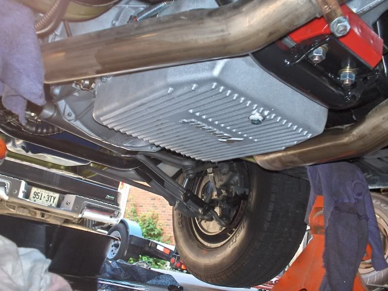

    here is a small picture of what I'm dealing with..
    fyi the trans is jack standed all the way up in the tunnel and the trans mount is very loose in the x member, not bolted down at all.
    I've got the one bolt in, then I swung the x member up and even pushing up with a jack I still have a small bit that it's off, as you can see in the picture. I can stick a smaller diameter bolt through the hole, and that's what I did on the other side to hold it, but the other side is off by the same amount
    I think I may take a small round file to the x member to hog it out...any other ideas?

  14. mav1970
    That is really close - I bet you're only dealing with Ford's quailty control from back in the day :burnout:
    Just run a drill bit through the holes and you'll be good to go :thumbs2:

    ya, the other side of that bolt hole is off by twice as much...
    I'm gonna clearance for what I need then drill the other side for that extra bolt....
