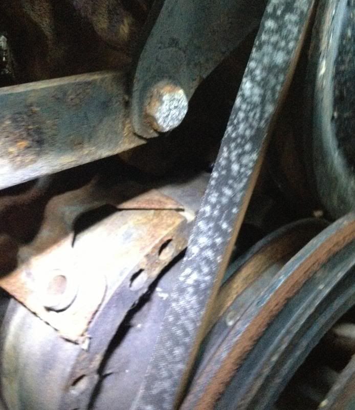

    After all of that, here's my question: I have the Chilton's manual and I know that I need to move the crankshaft damper to align the BTDC mark with the timing pointer. Problem is, I don't know what the BTDC mark looks like. Is it the notch in the damper? Here's a picture of the pointer lined up with the notch. Is this the correct position to mark the #1 spark plug point on the distributor and move the rotor to it before I drop it back in? Any help would be much appreciated.
  2. Dave B
    There should be marks, like on a ruler.

    Ah, yes. I found the ruler marks. It was so dirty, I had to wipe it down to find them. The Chilton manual has a diagram showing the ruler. It says that BTDC is at the 20 mark on the ruler. Is this where I should set the timing pointer?
  4. rthomas771
    8,074
    962
    Set the timing at 8*-12* BTDC...not 20*

    I'm not worried about the timing off the bat. I just want to know where to set it so I can find position of the #1 spark plug so I can point the rotor to it and reinstall the distributor.
  6. 71gold
    26,589
    2,935
    as above...once the compression has exhausted look at the pointer, rotate the motor by hand to get it to...TDC...on the damper, this is the...compression stroke.
    now find #1 plug wire in the cap and point the rotor to it, slide the dist. into the block. most times you will have to put it a tooth off so the dist. gear can mesh with the cam gear. the oil pump drive may cause it to not go all the way in at first. they have a tool for this or you can make one. don't just stick a socket on an extension and do it... the socket needs to be secured to the extension.
