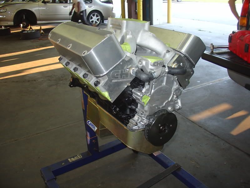

    ratio411, thanks for those pics. I was planning on cutting the shock towers no matter what. I'm pretty sure that my valve covers are even taller than your moroso's and it's a 9.5" deck block... I'm also going the custom header route because I'm doing a single turbo setup. Here's a pic of my motor, I don't think I could even drop it down far enough without the valve covers hitting.

    Those raised exhaust ports will give you fits for the headers too..Definitely custom ones. You may be on deck for a M2 setup instead...That rear sump pan wont work with stock Mav suspension either. That thing sure looks sweet...

    Get rid of the Fox oil pan!
    You might not get your tower braces on with those covers!
    My Morosos were real close to the braces and master cylinder.
    Just don't do what I did and run without braces!
    If you look real hard at the tops of my shock towers, you will
    see where the portapower dented them. I had to spread the
    towers back into place after running for a very short period
    without braces. The towers sagged so bad, the braces would
    not go back on.
