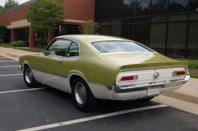

    whats the most common way(cheapest) to lower a mav/comet? also what is the common drop that people are doin( 1 inch, 2 inch, 1/1...)? if anyone has pics that would really help too

    do you have any pics after the lowering?
  15. igoback70
    igoback70 Member
    Aug 21, 2008
    382
    IN
    70 Maverick
    Man i knew you would ask me that, sorta ---- gimme a little bit to look through some of them. It's an 8.8 rear end also, and some of the picks the car may or may not have the air-shocks installed.
