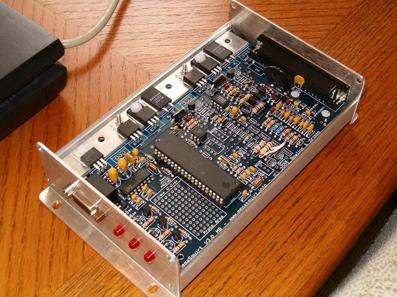

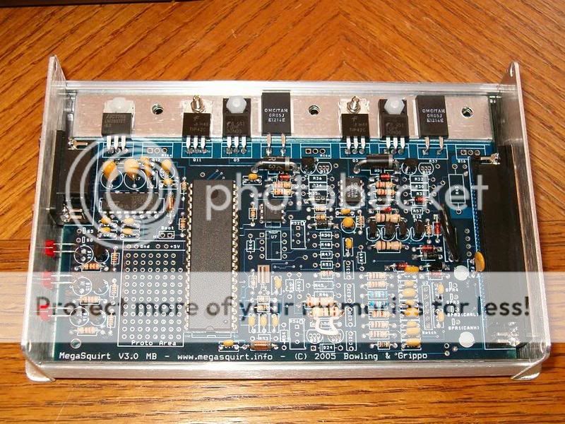

    I did buy the kit and soldered it myself. I had minimal experience soldering, and was able to complete the MS very easily. The soldering I have done is on tiny surface mount components such as PC video card volt mods, and the MS-I was very easy compared to that. If you buy a decent 15/30 watt pen style soldering iron, you should have no problem soldering the MS-I kit together after a little bit of practice.

    MS-I does allow spark control with a few simple assembly mods during the build, and a software update. Megasquirt-n-Spark-Extra is the code I abbreviated earlier. It allows full control of fuel and spark. Also, it controls air idle motors, be it stepper, on/off, or PWM such as the stock EFI ford units. It allows some other things such as rev limiter functionality.
