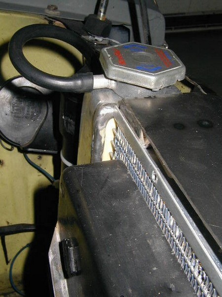

    The car is a 306 gt40x combo with trick flow cam and 600cfm edelbrock carb.
    So stop and go 25mph traffic putting along sitting at a light and this thing is pegged on the gauge at 180. Even while cruising its at 180 degrees. I think maybe the classic instruments temp sensor reads a bit high. But it does boil over if you let it idle for awhile. I can let it idle for a really long time and it is rock solid at 180. But stop and go/cruise and stop, it creeps up when you stop to around 200 and spits coolant.
    I have a 100$ electric fan from O'Reileys it moves quite a bit of air and is powered by a nice thermostat relay thing. It does not have a shroud but covers about 75% of the radiator on its own.
    The water pump is a Proform Electric Pump.
    Thermostat is a 160 degree stant brand I think.
    Timing is set to like 10 degrees IIRC I set it awhile ago.
    Motor is pretty much new has only 200 miles on it.
    The radiator is a silla 2 row all aluminum with trans cooler provisions that are not used.
    I think I need to get a bigger radiator but am not sure. :huh:
    What do you recommend?

    The removal of the thermostat "guts" helped quite a bit. It does creep up to about 200-210 and spit a few dribbles, but if let idling it will cool itself back down in a minute or so back down to 180. Seems to want to hold 180 if it just sits idling with the fan on.
    I also agree my fan is DEFINITELY not up to the task of keeping this thing cool in around town driving if I jam a couple gears and stop.
