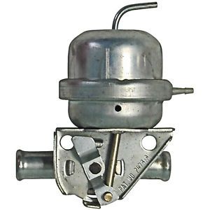

    Water valve not getting vacuum or stuck in the closed position.
    Get the car well warmed up and turn heater on. See if hose is hot on both sides of the water valve. If not, use hands to push or pull the lever to open the valve.
    If it moves, hose should now get hot and you should have heat. Wire it to the open position.
    If you cannot move to the open position, valve is stuck. Remove it and replace section with new hose or copper pipe in place of valve.

    Well, where is the water valve located? Pictures?
  15. Krazy Comet
    7,717
    2,433
    Looks like this, mounts on firewall at right hand side of brace that bolts on top of shock tower...
