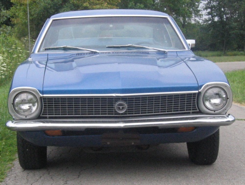

  6. Craig Selvey
    18,333
    1,381
    This is a Maverick bumper. Your car should already have this bumper.

  9. mav1970
    Then you just need to look for 70 to 72 front and rear Maverick bumpers in good shape. A Comet front bumper sticks out too far in the front and will not conform to your Maverick grill and hood. Now a 71-73 rear Comet bumper I believe are the same as your Maverick.
