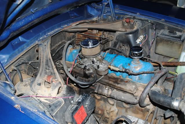

    btw have you tried this air filter kit?
