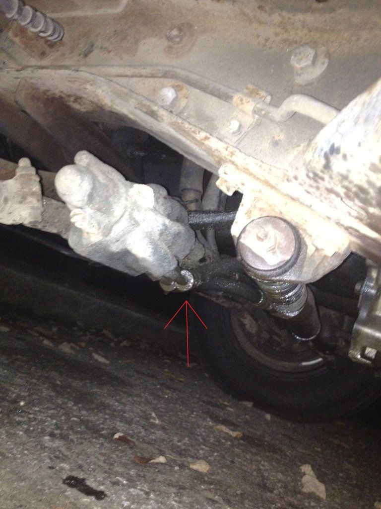

    Alrighty folks- here's a pic of the underside of the car, with an arrow pointing to where I think the leak is coming from. Is it pretty simple/straightforward to redo these lines? as far as I know these lines are original.
  10. 71gold
    yep...looks like all the rest of the leaking, messy power assist setups I've seen...I replaced my lines twice before i went...manual...:bouncy:

    As I stated in your other post, verify where the leak is first.
    You also need to get your hands on a Chilton manual or the Ford service manuals. Fixing this leak is more than just swapping hoses. The system will need to be bled as well once repaired.
