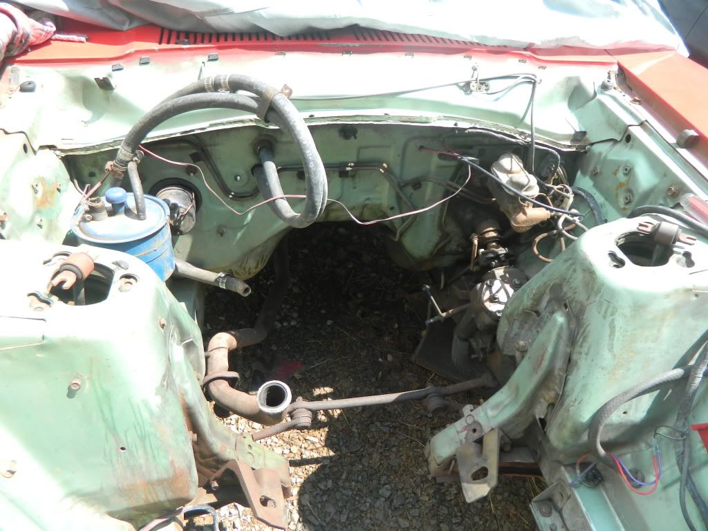

  8. Mavman72
    Couple rags...Brake clean and some sandpaper/primer and rattle can paint gets you this. Took about 6 hrs of prep the get this result. Really cheap paint will not get you good results either unless you are super patient with it. I used duplicolor paints for the Sprint. I actually pressure washed the eng comp before this before pic was taken...It was pretty ugly.
