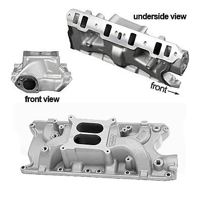

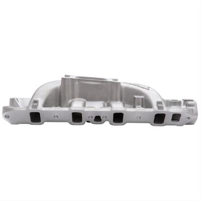

    Well Maybe I was wrong about the factory manifolds. Ive found some that have the rear cross over and some that dont. And on the aftermarket side its hit and miss. some single planes without cross overs and dual planes with them and vice versa.
    But I'm with Frank inthat I prefer to have the rear crossover for better cooling and less air trapped. Plus my first Performer manifold was trashed from corrosion back where it blocked the passage.
    I guess its just a personal preference thatmight not even need to be considered when picking a manifold. I havent found anything in print saying one is better than the other, just gotta go off of what you have experienced for yourself i guess.
    Weiand Stealth With cross over
    Edelbrock Performer RPM, looks like they are back to no cross overs. At some point they had cross overs bacause I have one :huh:
    Heres an edelbrock perfromer part number 3723, it has water passages
