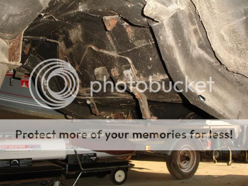

  8. mercgt73
    You can see them near the top of this image: [​IMG]
