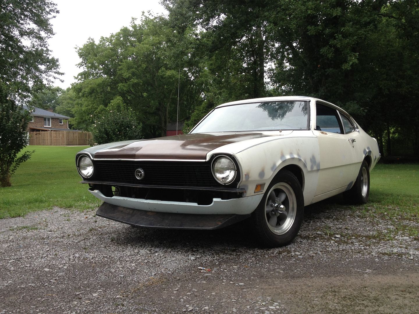

    image_626642_original.jpg Craigs thread on chin spoilers is the route I used, worked great for me.:thumbs2:

    That looks really good. I have a modified Pinto spoiler on mine and I'm afraid it hangs too low. Still debating whether to use it or not.
