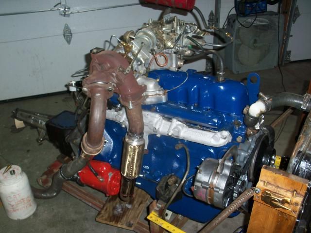

    ... started road-tuning the small block six 250cid turbo motor in the '74 Maverick. It uses a carbureted 80's BOP V6 turbo setup grafted onto the 250 . First stage is to get the project road-manageable and then to continue with equipping the Maverick for close to double the original RWHP.

    I love the combo, the only thing I would do different is the air cleaner. While working in an auto parts store, I saw way too many of those come in where people were looking for new foam. After enough heat cycles, backfires and general age, the foam gets dry and eventually comes off and goes through the engine.

    X2 on air cleaner I had one and had a backfire instant fireball on to of engine. Cool build
