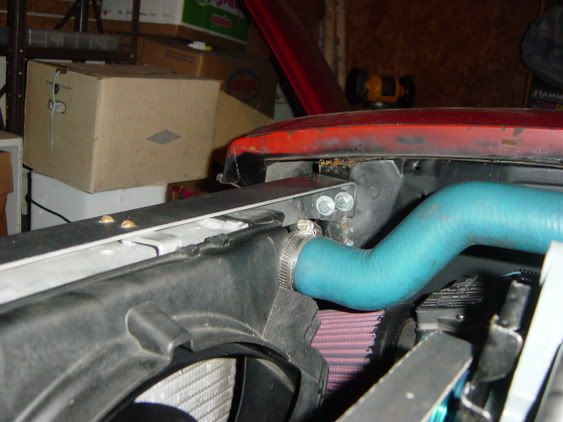

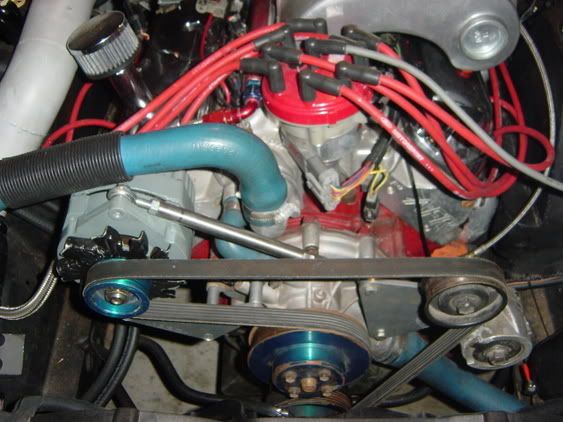

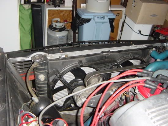

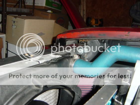

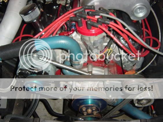

    The Radiator is apprx 28" Wide X 18-1/2" Tall X 3" Thick.
    Note: This is a work in progress, but the radiator part of the project is done. I will be going to a single V-belt (to the one-wire alternator) before I take it to the track.
    Can you tell by the rust on the pullies how little the engine has run?
    Note also the '90 Mustang belt tensioner 'reversed' (by removing the spring inside it and turning it around).
    Current set-up
    "New" Radiator Support (Aluminum Angle):[​IMG]
    Ram Charger Dual Electric Fans
    You can't see it in the pictures but the Mustang radiator outlet (going to the bottom of the water pump) is directly in line with the channel of the 'frame'. I cut off the end of the channel and ran the hose through it. I cut a hole out of the channel (on the inboard side) where the hose could be routed through to the WP inlet. I split a vacuum hose and put it around the hole in the channel to keep the hose from rubbing against the metal.
