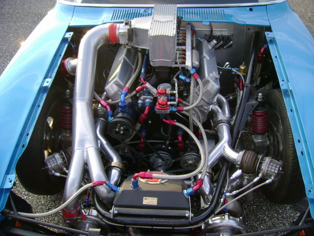

    Never seen twins on a big block maverick, most people are smart and go with one because it's just better all around.
    There's several small block mavericks running twins:
    by splattergraphics, on Flickr
    there's a couple on youtube also.

    Cool link and pics. If I was to do it I would have to insist on it all fitting under the stock hood. I think I would also like it to be carbed to keep the expense down. Of course this is an idea I have since I have 2 good low compression 460's and no other use for them.
