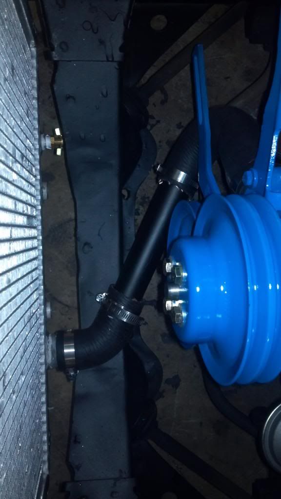

    this is what i ended up doing. its kinda ghetto but theres plenty of room between the pulley and the pipe.

    I don't think it is ghetto. Looks nice, is functional and solved your problem. (y)

    Looks OK to me. I don't see why u think it's Ghetto? That's a pretty engine. Is the rest of the engine bay that nice?

    Pic's too dark to tell anything. Sometimes you just have to "improvise"
