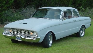

    3000 is not a lot. That's where I get the best gas mileage (19.75 mpg) in my Falcon. Here's me at 75 miles an hour in the slow lane going to work 80 mile commute.

    The slow lane is aka chevy lane! love that dd falcon! Show us a picture.
