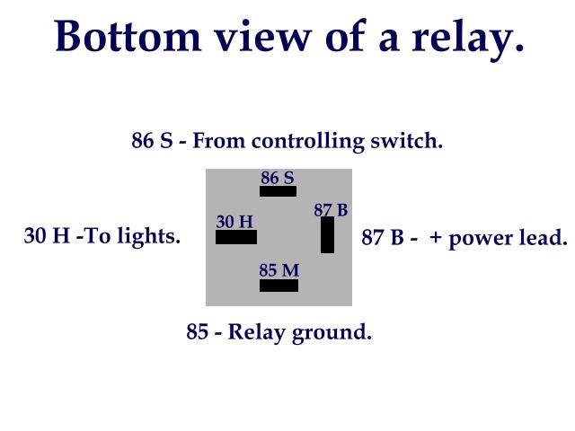

    I just bought a flex light electrical fan and was hooking up the wires. so i ran the postive wire to the only 12v wire that i know of under the hood ove by the drivers strut tower. It did not run nearly as fast as when i hooked it up to the battery by itself. I also have my msd hooked up tp that wire just to give the signal to let the msd box to turn on. I kept turning the key for ward a couple of times to make sure it was working when my msd box blew up. Any sugestion on where to put the wire for the fan that wont some how blow up my msd box? thank you for all of your help.
  2. Bryant
    use a relay to turn on the fan. it can take the main power directly from the battery and you can use the power wire youve been using to triger the relay.
    the reason it blew your msd is that when you turn on the fan and turn it off it will create voltage spikes and with the key turned off the spike went to the msd.
  3. gtpictor
    gtpictor Member
    Jun 19, 2008
    chicago
    maverick
    that is kind of what im thinking happened. I have been reading a wiki site about relays but not sure how to hook one up. thank you for confirming my thoughts.
  4. Bryant
    heres how you do it. its really simple.
    just put where it says 30 to lights to the fan postive side. 86 will goto the wire you were useing.
  5. gtpictor
    gtpictor Member
    Jun 19, 2008
    chicago
    maverick
    just finnished it up and it working well. Now i don't suppose you know how to open and rebuild an msd box? (j/k) Thank you again for your help and the picture.
  6. Bryant
    msd has treated me well with fixing damaged boxes. contact them and see what they will do for you.
  7. rthomas771
    8,074
    962
    Actually terminal 30 is the 12v feed but it really doesn't matter in real life...only on paper
