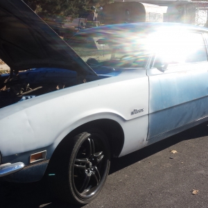

    Here is a newer picture showing the exhaust. The tail lights are from a 1970 Torino.
  6. mojo
    5,283
    839
    U got nice build going Greg, just wondering why exhaust is coming out right at pass door? No concern abt getting c-monoxide in the pass compartment?
  7. gregmaverick
    gregmaverick Member
    Sep 7, 2011
    429
    52
    Salem, OR
    1970 maverick
    No, I never smell exhaust (And yes, carbon monoxide is odorless & colorless).
    1) It sounds great
    2) Less restrictive.
    3) This summer (or spring...rains a lot in Oregon), I may run two pipes back to the rear on the passenger side - following the original exhaust route. Or, use a "Y" pipe, and run a single 2 1/2". The "Y" pipes you generally find, are used to split a single exhaust. But, they don't work backwards! If you notice that the 2 ended side are facing each other.
