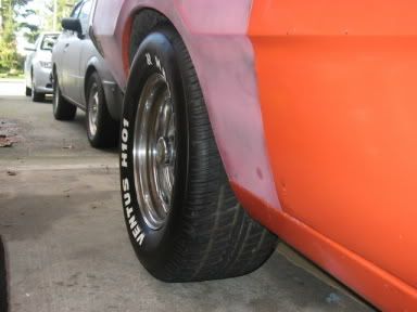

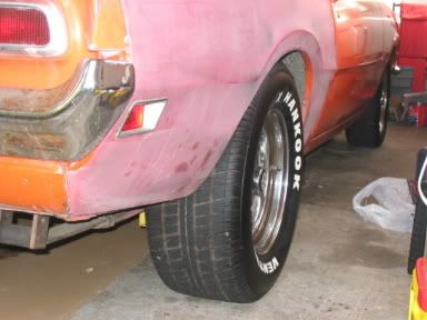

    The 50's might have a tougher time thatn the 60's fitting on the 4 1/4 BS. generally a shorter tire on the same wheel will (to a point, would be nit pickers) present a bit wider cross section.
    Have a close look at the pictures I posted. The 60's didn't come out beyond the wheel as far as the 50's.

    Mine were 275/60r15 on Cragars with 4 1/4 BS.
    They "fit".
    Maybe it would've caused a problem eventually.
    After all I only drove it this way for a couple of years.
