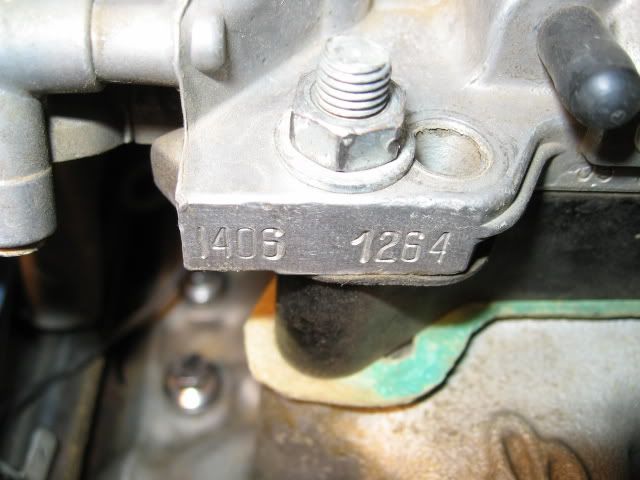

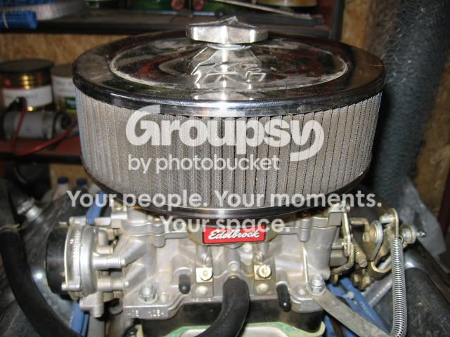

  12. Reeves1
    Reeves1 Member
    Jan 7, 2011
    87
    Alberta Canada
    The 1406 I have (and trying to sell - not the intake though) is electric.
