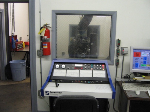

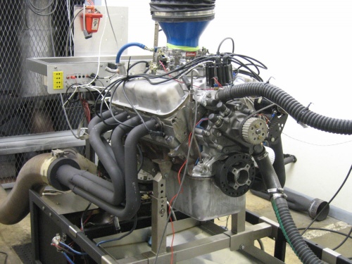

    Oh yeah, here is my little 302 on the dyno being broken in. While others "blue sky" their numbers....I have the print out to prove it.
    358 horsepower / 384 ft. pounds of torque

    Lookin good. AC car to. What color is that on the engine? Are them holes in them pretty towers for grease fittings ?

    Yes....AC car.
    The blue is the Por-15 Ford engine paint. Turned out a little dark....but it should look good once I get the rest of the motor back together.
    Yes....holes for greasing the fittings. They will be plugged with rubber floor plugs for a factory look.

    Man .. if that engine is blue you need a new camera! :) ... Looks like late model grey ...

    It is blue....just a little dark inside that part of my garage.
