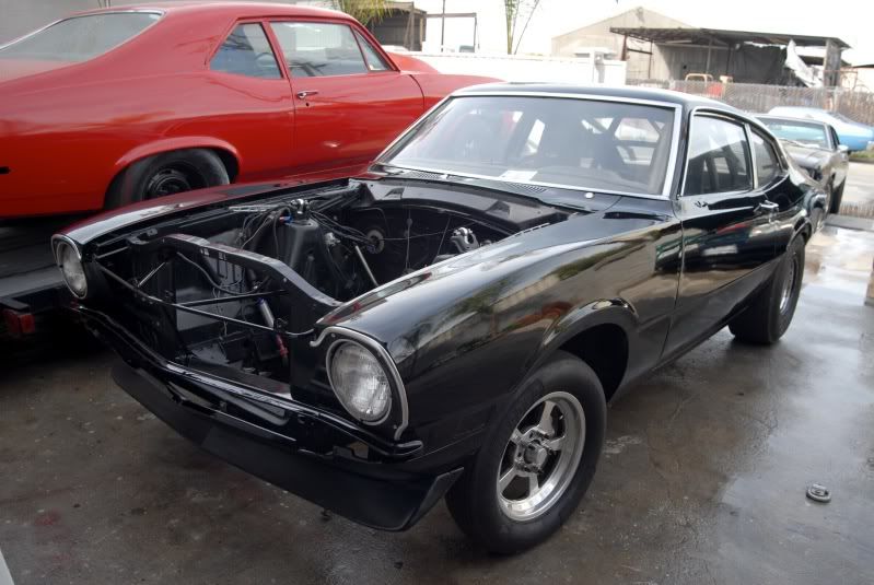

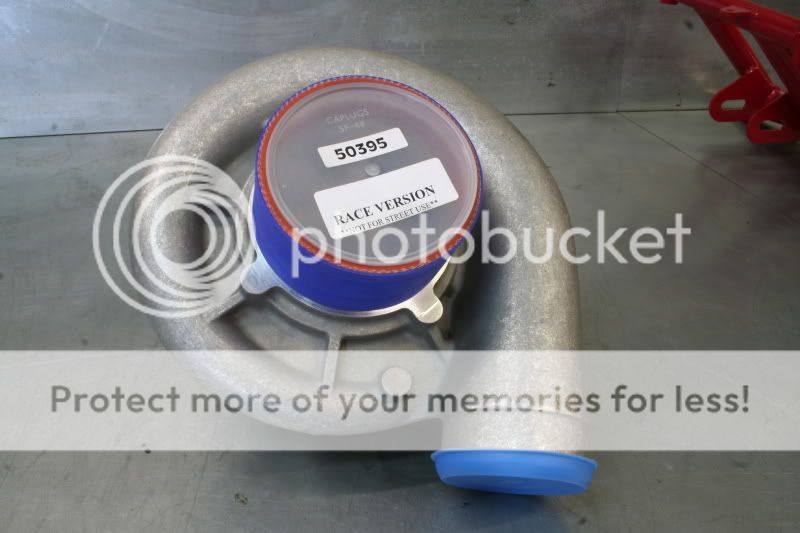

    Hey guys, I thought I'd share some progress pics of my Maverick.

    That is an impressive car.

    wow looks like it is going to be bada$$. very nice work.

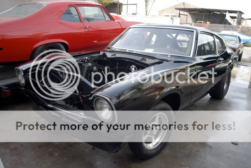

    Bad news though... That turbo says "Not for street use" therefore you must change the title of this thread. LOL

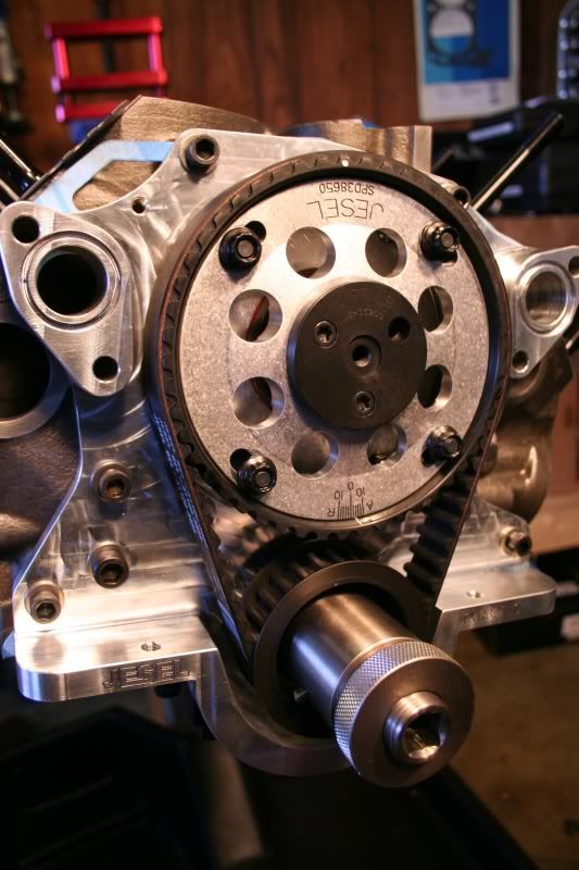

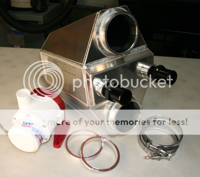

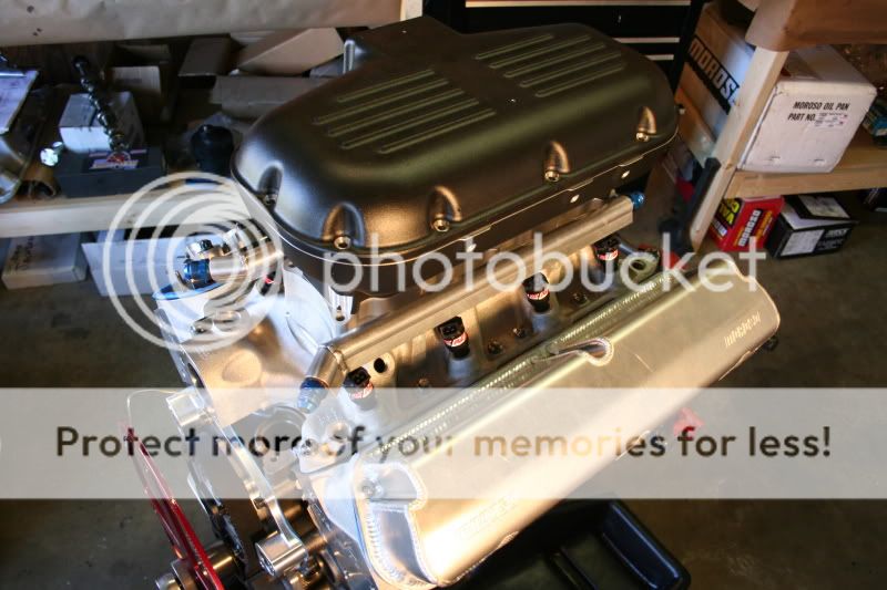

    It's going to be a 310 SBF, Trick Flow heads by Total Engine Airflow, Vortech YSi supercharger, PT2000 intercooler, EFI, Powerglide, Drag Radials.
    I was originally trying to build the car for PSCA limited street, but there were certain things about the rules I didn't like so I'm probably going to run in Wild Street for the heck of it. It should run low 8s in the quarter.
