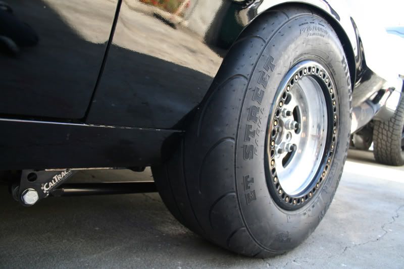

    The setup is:
    The combo is a 310 c.i. Dart block, TFS Track Heat heads by Total Engine Airflow, solid roller, Vortech YSi blower, A2W intercooler, Powerglide trans, 8.8 rear, M/T Radial, Cal Tracs, AFCO dble. adjustable shock, AJE front suspension, 25.5 Moly cage.

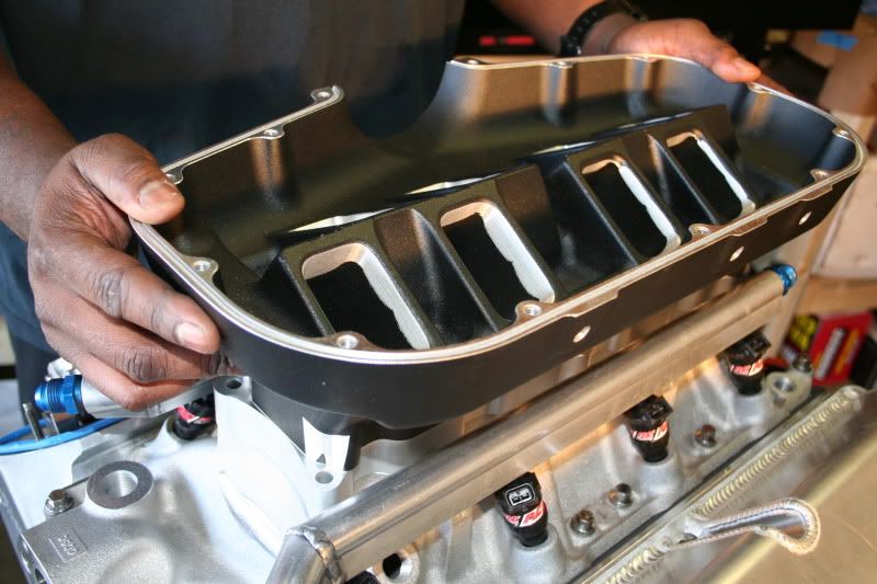

    This is the intake I'm running, a Trick Flow R-Series. The Nova you see in the background is a fiberglass front end, LS1 swap car. It's a project for one of the guys at Vaca Performance in Downey, out here in SoCal. They've got all kinds of cool cars there, mine's there because I'm writing an article on swapping on an AJE tubular front end.

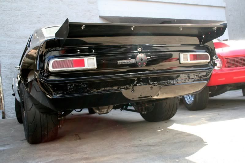

    Here are some updates. Do you think I should pain the screws holding the trim ring in place too?

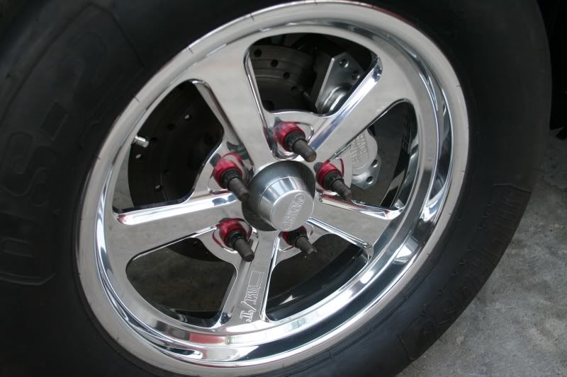

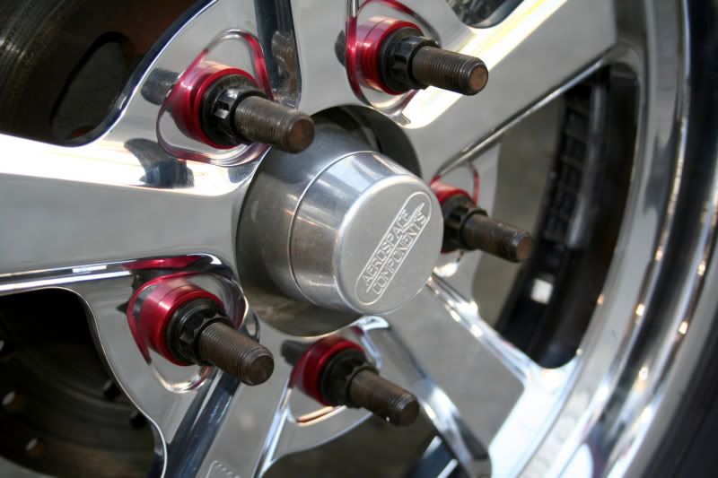

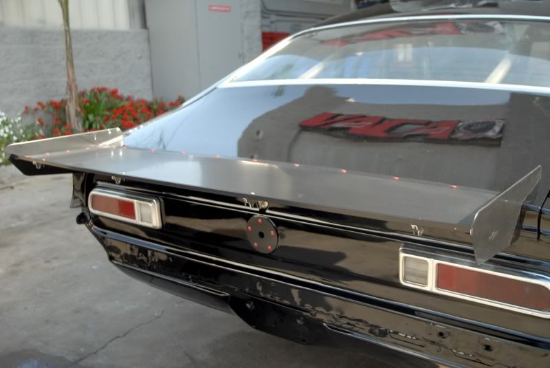

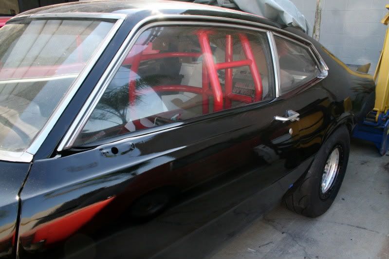

    Some new Pics. The windows will be tinted to hide the cage. I may go with a darker red, but these pics are of when it's still drying.
