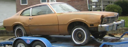

    From that picture.....looks like the car was originally a brown color, like this.

    maybe i shouldve been more clear on the colour. i know exactly what the ORIGINAL paint colour is, its cinnamon and its the inside of the fenders tht show it. nothing has been "hacked" off of the fenders, its just the way the pic looks. i honestly dont care if its factory or not, i like the look of it very much, i just want to be sure. ill post pics in a bit
