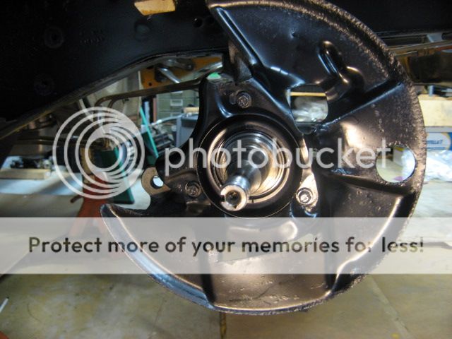

    Well I have more tales of brake/spindle woe but I think it's all sorted through... I've found the spindles don't match, LH is the larger big bearing type('70-up), but has the small tie rod socket(pre '70), never knew such existed... I'm not 100% sure but it's possible it's a 1969 Boss 302 spindle... In searching the web, apparently there were three different Boss spindles used, from the std '69 to a interim spindle, while late builds got the '70 parts... The casting number is so weak I can't read it but it does appear to have a C9 number... Std '69 Stang/Torino spindles have a C8 number(my RH) while the '70 models have a D0 prefix... I do know the spindles came from a '69 Torino GT, apparently the LH was swapped somewhere in it's life...
    Anyway all I have to do is use the '70 bearings and it's good to go...
    Next I decided the back plate/dust shields were too far gone to be happy about, soooo I set out to use what I had on hand, which would be from my 1988 Turbo Coupe parts car... Well after some drilling and massaging with the BFH, they turned out fairly well... The mounting hole at 12 o'clock had to be moved approx 5/16 to right while the one at approx 9 just required elongating slightly... The hole at 4 o'clock didn't exist (orig is at 3, area now curved), I had to massage that area flat to be able to drill the hole... Once it was mounted, there was heavy duty massaging in several areas as rotor dragged badly in several spots... All in all they turned out pretty good but I'm sure something else more period would be easier to work with... At least they are good enough till the bank account is refreshed a bit...

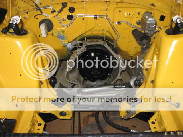

    Excepting for wiring harness engine bay is mostly finished, still have to swap the torque converter(need to drain orig)... Somehow the front crossmember didn't look right painted body color, fixed that with the trusty semi-gloss black...
    Steering linkage was going to wait till after engine install but after I mocked it up, decided was too much trouble to remove so went ahead and bolted in in place... I 've left the P/S cylinder loose can drop it for extra space... Stanley(tape) & I set the toe earlier today, it's close enough till I can run it over the Ouija board...
    Since it doesn't leak, thinking I'll just cover the patched trans line with plastic snake skin, removing that line from trans is a total nightmare... Also I'm still agonizing on the P/S pressure line as well, got far more line than space...
    Little things continue to pop up, can't open the master cylinder till I shorten this stud holding the pedal/steering bracket assembly...

    Converter is in place
    Still need to make a couple repairs to the wiring harness, which I'll do after engine install... Also I'm going to modify the engine harness to better fit the 306(it's a mess anyway), and build a fresh harness for the 2G alt... Yeah I hear the boo & hiss now, but I have two fairly fresh ones and as long as the battery plug is good(it's new), isn't likely they'll burn up... Anyway it's easy to convert to a 3G from a 2G...
