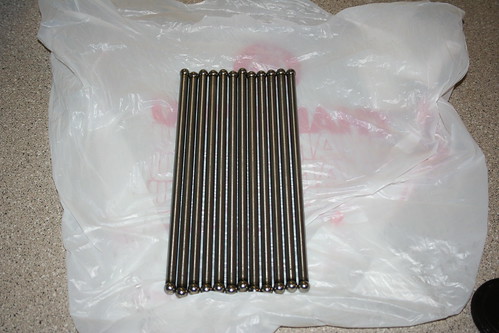

    I got a whole new set of push rods in the engine installed today. As soon as my wife gets home, I am going to charge up the battery (I left the keys in it in the garage like a fool) and see how she does. I'll post some pictures later!

    Well, I got a whole new set of push rods (Blaine's in Dallas ROCKS), and got her fixed. The cylinder fires, and you can certainly hear the timing off, and I think I have a clicking lifter. It has certainly got some power!

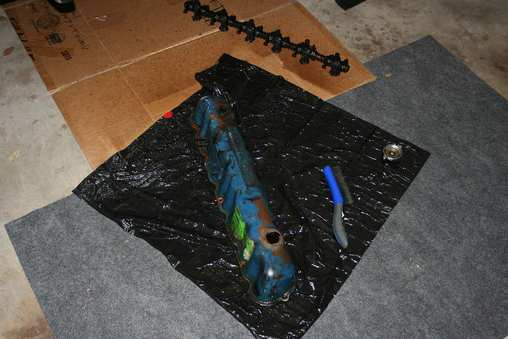

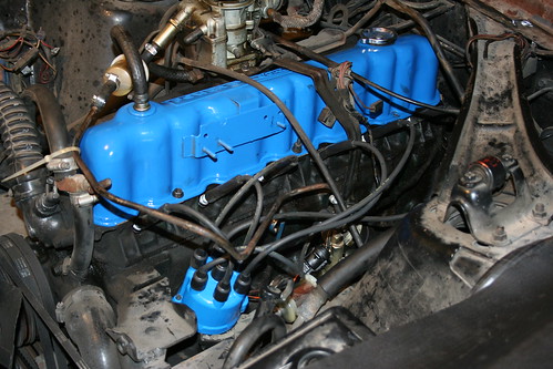

    In the picture above you can see a bolt hole on the right side of that valve cover. The head of that bolt snapped right off when I was installing the cover. That GOD that the bolt hole on the head goes all the way through - now where do I get a set of bolts? :)
    That was a lot of fun! I wonder what else will go wrong? :burnout:

    Take a bolt with you to an auto store and match it.

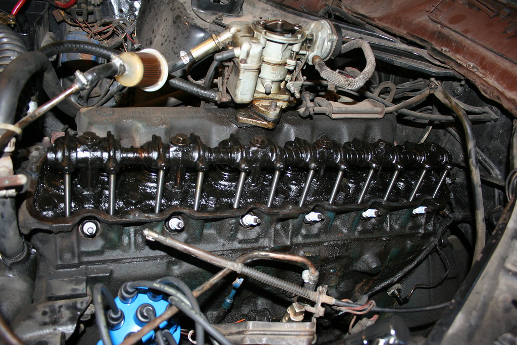

    I must be seeing things. It looks like there is a nut missing on the base of the carb.

    gene you are right. it was missing in the first pic. if you look at the second one real close after everything has been reinstalled its there holding that bracket on that crosses the valve cover. good eye though(y). the sound of the engine definatley has an erratic missfire to it.
