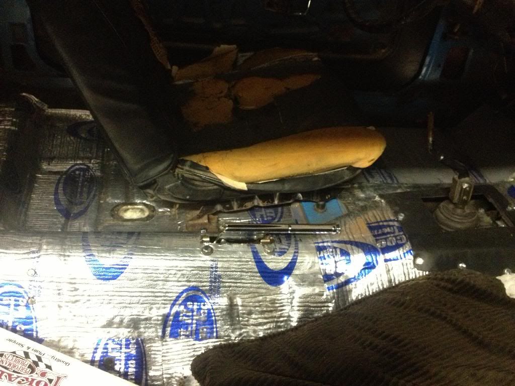

    Installed a lokar floor handle emergency brake. Works really good and the install was a breeze.

    Doesn't come with cables. It's about $250 for the handle and cables. I know it's somewhat pricey but well worth it. One of the best mods I've done.

    Nice setup! Don't have all the hdwe the OE setup. I am wondering if there may/will be a problem w/ driveshaft and cables touching. Otherwise, I will consider going w/ that setup.
    Is there some kind of rubber boot to cover the base of the brake handle?
    Does the trans have to be out to install it?

    I installed it with the trans installed. Cables are secured so they won't move around. There's a boot you could buy from Lokar but since I'm not ready for carpet yet I'll wait till I need to buy it. I have most of the OE stuff except the cables that attach to the rear end if you need it. Just cover shipping and an adult beverage for me to consume while I box it all up and it's yours.

    My car has all the OE parts; but, thanks for the offer. So, I assume u drop the tail shaft to install that unit? Also, appx. how much room between drvshaft and anything on the newly installed unit?▐

    Nothing on the trans needed to be removed. Only parts that were in the way were the exhaust and driveshaft. It's about a half inch from the driveshaft which should be plenty of room. You could even keep the exhaust if you wanted to. I just had to take my trans out for a new flywheel.
