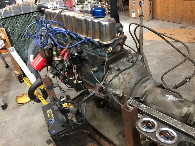

    where would the tag usually be? .
    I'm strictly a three pedal builder but the 76 Comet GT donor had a 200 with a C4. I as surprised to find the 1976 Comet 200 block still had machined the small bellhouse bolt pattern inherited from the earliest Falcon / Comet small block six engine castings for 'peanut' 3spd stick and air-cooled 2 spd Fordamatic. the small bellhouse needs the odd converter but not sure of the C4's internals by '76, Ford was standardizing everything by then 6 vs 8.
    have fun
    C4 / 1976 Comet GT 200
