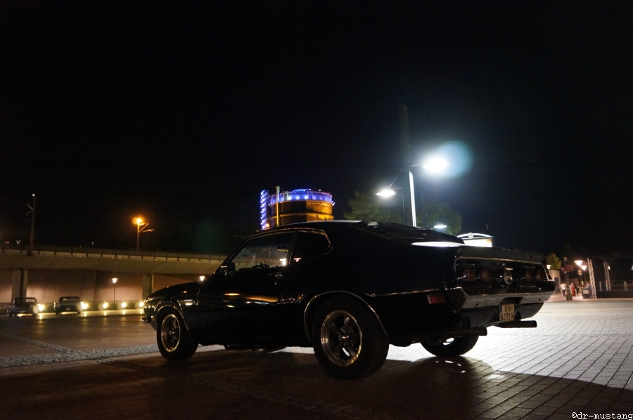

    attended a big car show last weekend.
    here's a nice shot from friday evening:
