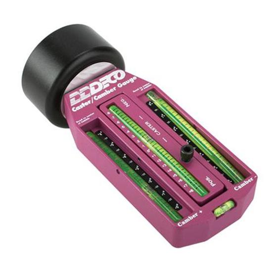

    I have the same gauge that I bought back in my stock car racing days but just made by Longacre - I just have to buy the Pinto spindle adaptor as I only have the adaptor for Chevy spindles right now - some cat litter under the front tires instead of turn plates and I'll be good to go :)

    AWESOME!!!
    I have an alignment issue, AGAIN, with my truck. This might be my permanent solution!

    This gauge will not fit my Billet Specialties wheels. What I did was make a set of wood blocks to go under the front control arms so the ride height/suspension loading remains unchanged. Block it at ride height, then remove the front wheels and stick this tool on the spindle and have at it. A bit more work, but then there's no slip plates needed for the tires...
