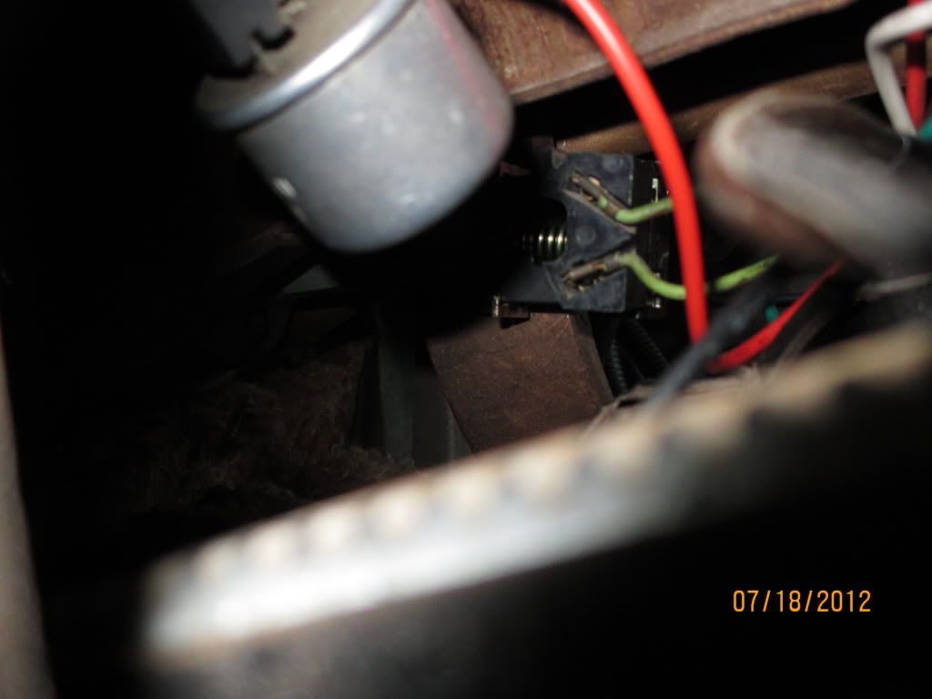

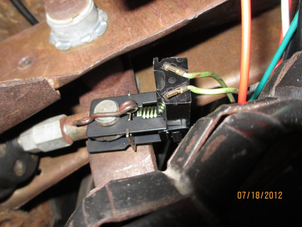

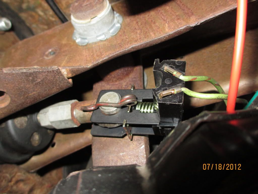

    No I installed it correctly the U sidewent towards the inside.Here are some pictures of my old switch and my new one.

    Which is the piston rod?
