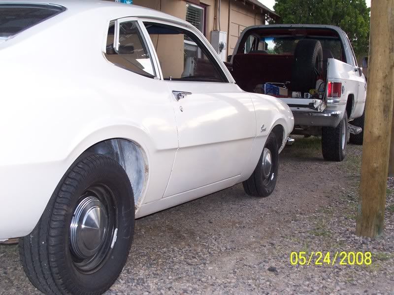

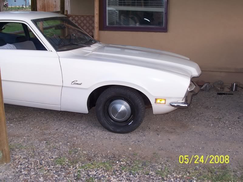

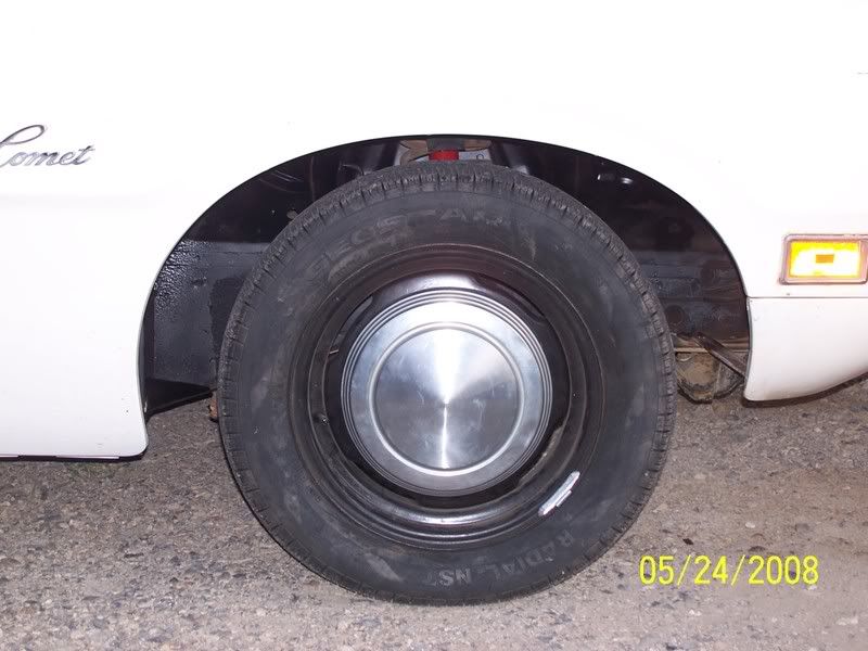

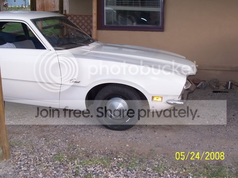

  12. joshua_mcgehee
    joshua_mcgehee Member
    Apr 26, 2008
    330
    Montana
    1971 Comet
    As promised, heres the pictures.
    Well does it look ok?
  13. don graham
    Looks like i sits pretty good to me. Might even settle down a little bit more. Or maybe not since you are keeping the 6 in it.:)
  14. rayzorsharp
    I agree (y)
  15. tim keck
    Jul 4, 2004
    1,991
    sharps chapel,Tn
    Definitely don't need shackles,looks good as is.
