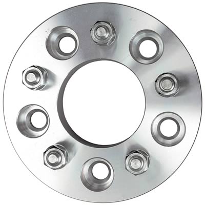

    These are what I'm talking about:
    http://www.summitracing.com/parts/TRD-3614/
    ...Some of them change the bolt pattern, some don't, but same idea. The reason I always say "adapter" instead of "spacer" is I don't want to give people the impression that I'm running those "straight through" spacers where you just install longer studs on the hub and put a plain piece of round cast aluminum or steel over it. I don't want people to think I'm saying those are safe, because I don't think they are.
    As long as they're installed right, evenly torqued but not overtightened, flat against the mounting surfaces, and the resulting position of the wheel relative to the hub is sane, the type of spacer/adapter shown above should be perfectly safe. The material they're made of is at least as strong as the wheel.
    I have never heard of anyone breaking these, or having any problems resulting from them.
